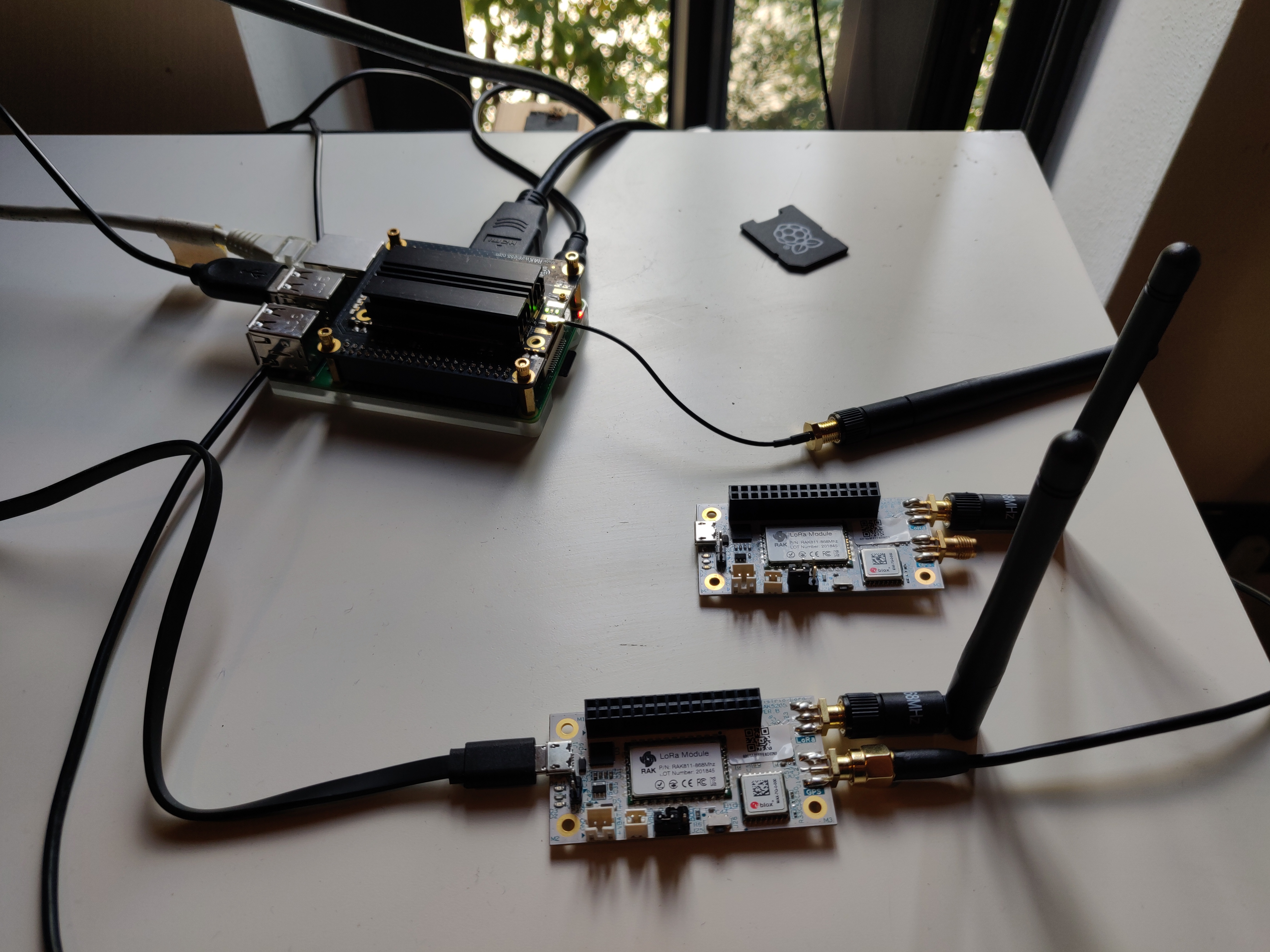

I would like an account for RAK online compiler. Here you have my data:
- Name: Pablo Romero
- Email: [email protected]
- Products: 2 x Wistrio 5205, RAK 831 GW + RPi and RAK 2243 + RPi.
- Images:
Thanks for everything in advance!
